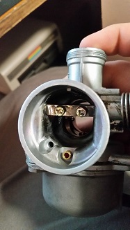

Pz25
This is where the plate was.

Hopefully it just got stuck in the intake valve and not letting it close.

That royally sucks. That is not a part that should freaking break. I'd be livid over that. I see the two phillips head screws, they didn't loosen up, the plate just broke? What the hell is up with that? Did you get stranded far?

It wasn't too bad, Just a nearby town. I kind of worry about taking it to busy areas. All I had to do to take it home was toss it in the back of a truck with the help of another person. really light bike, I could see an opportunistic thief going for it at some point.
I was unsure if the plate just got too loose and the vibration broke it in half, but It looked as if the screw heads were tightened down pretty hard on the piece I found.

highlighted choke plate
The red part got sucked into the engine, I have the green part around here somewhere.
I bought this bike with the intention of learning about the mechanics of it all, but I never really planned for this kind of issue.
Would it be a decent idea to take just the head off and look around in there for a start?
Old 05-17-2018, 08:24 PM   #10
Posts: 11,581
That big of a piece couldn't of gotten to far. I would pull the head.

You sure its not just stuck in the intake pipe?
If its in the head hopefully it didn't tear anything up in there.

X2 on pulling the intake tube, like Chinabike says. You might get luck and be able to fish it out with needle nose pliers. A magnet might also do the trick, since the intake and the head are likely alloy, whereas the choke plate is probably plated steel.

Do what Weldangrind said first before you pull head. Try a long flexible magnet
